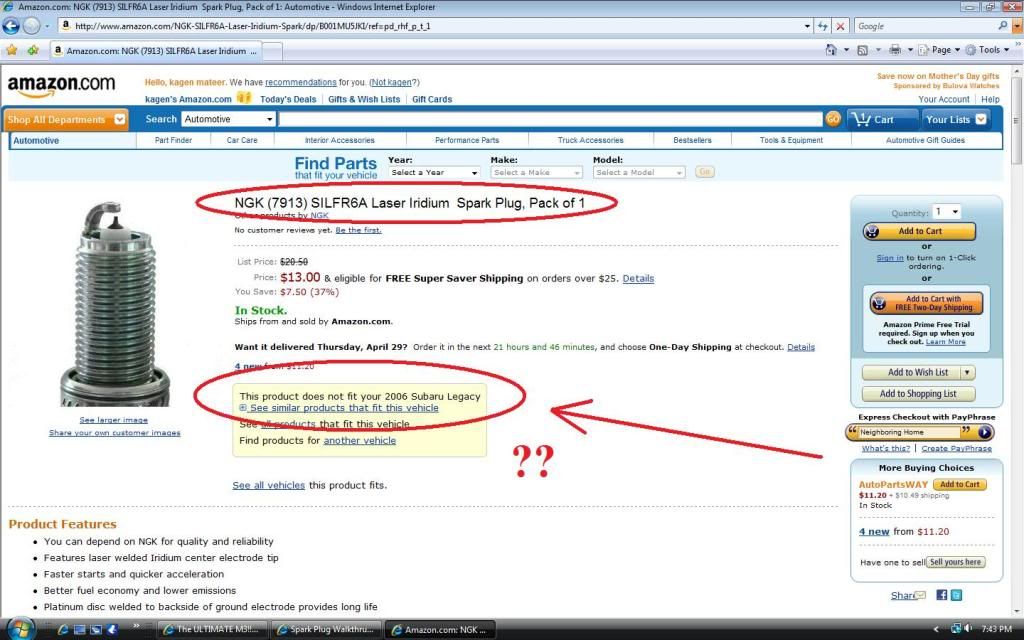

What is this about? I went to order plugs from Amazon and it has a handy-dandy checker to make sure that what you're buying fits your car, so I figured I'd give it a shot.

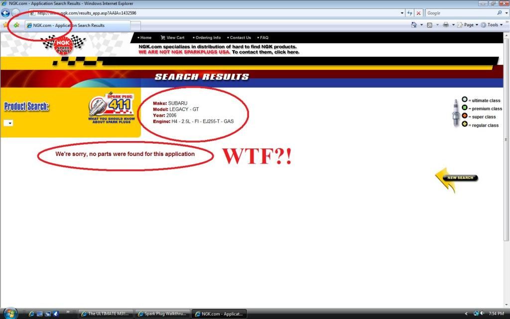

Now look at this ****...
Old 04-27-2010, 06:00 PM   #11
Posts: 1,277
NGK's site lists only a 2005 for SILFR6A. They need to get their **** together.
*edit* Apparently you have to go to ngksparkplugs.com and not ngk.com http://www.ngksparkplugs.com/part_fi...uv/results.asp
